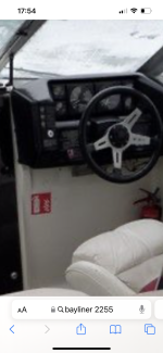

Hold on. Just thinking on it now. My 1990 bayliner 2255 didn’t have a lanyard on the remotes. It was attached to a red toggle on the dash.
QBhoy
Mar 10, 2016
8,348
Hold on. Just thinking on it now. My 1990 bayliner 2255 didn’t have a lanyard on the remotes. It was attached to a red toggle on the dash. Just to the left of the steering wheel in picture
