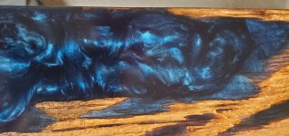

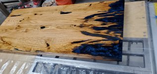

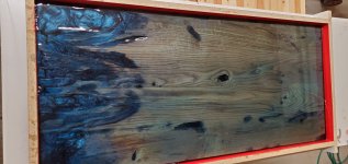

I would not do an upside down pour, as there will be bubbles on the underside that will not pop [at least in my experience]. On my tables, the top of the epoxy was a around a 1/16th below the wood. You can kind of see it in the first picture.
I used a blue dye and then added blue, green and silver mica powders which give a nice pearlescent shimmer. The second pic is a good pic of the look.

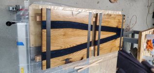

These are a coffee table and end tables that I made from a reclaimed oak post out of an old farmhouse basement. The bottom of the post was dry rotted, so I just wire wheeled the rot away after I had re-sawn the post and used the epoxy to accentuate the ragged edge. The iron bands on the end tables are to cover up a screw up.
Still working on the bases...

very nice, that is a very dark blue. I don't see the green mica, but then thats why i failed the painting part of art class in high school.

I added a bit of black dye to darken the blue, and the green is verrrrry subtle, more of a hint really. The light has to hit it just right. I did that in two pours because I miscalculated my volume and had to order more epoxy. 🤬 I added the mica when mixing. The first pour had more black in it, but I dialed that back for the second pour, giving it that deep, dark look. [more accidental than anything, but I'm claiming it as a win]
