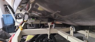

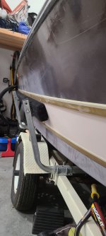

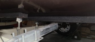

The transom appears to actually be in good condition. Started pulling out some of the rotted stringers and after reading some other forums threads some mentioned needing a cradle while others said they did it on the trailer. I understand the need for the cradle so that the hill doesn't warp and hook so what I did was move in the trailer supports as tight as physics would allow for me to do. After looking at some cradles I feel like this will serve the same purpose.20210130_134152.jpg20210130_134200.jpg20210130_134231.jpg

That’s probably possible, but if sounds like much more work than making sure the hull is properly supported and then gutting it. I don’t know what everyone else thinks, but it looks to me like the steps you’ve taken so far should properly support your hull while you do your work.

Bunk trailers make good cradles. Just add some temporary support at the chines and a wee bit of support up towards the bow if it does not have any and you will be good to go for a full cut & gut.
