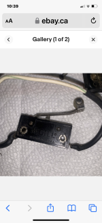

Holy crap! I can’t believe how lucky I am! Found one 10 minutes from my house, $35!
