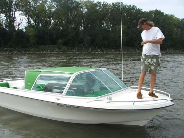

evening sns.... i think yer tryin to turn yer ss215v into an aristocraft.....:)
the deck is non skid, the whole deck. fore to aft..... i'm cuddyless though..... no comments please on my pfd..... i see my mistake thankyou..........

i migh have to move stanchions forward
instead of moveing it fwd. maybe just add one ea. side to stabilize the ft. of it. then ya could have 3 or 4 pts of contact per side. the 4th one being the aft one. which ya might get away w/o..... per yer last pic...
