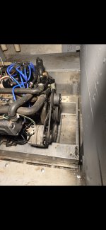

This shows the space I'm working with. The area in front of it is an empty cargo hold.
