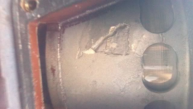

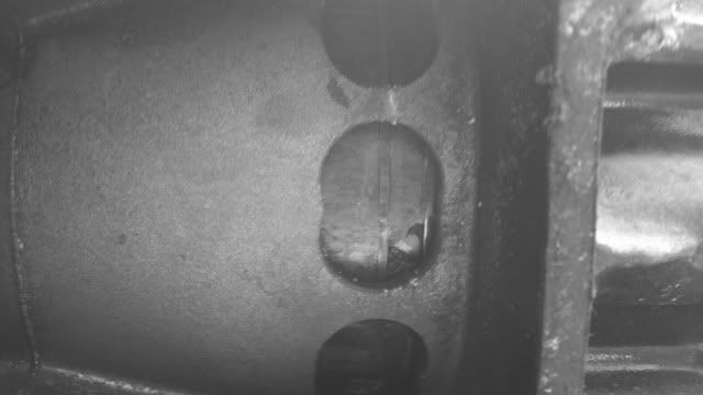

I have a '79 150hp Evinrude that has a blown piston (top port side) I believe it was due to overheating or carbon build up as it still has the high ring groove pistons. As I was inspecting the block I noticed cracks between the intake scallops. They don't go into the sleeve. I was just wondering if the block is still useable or if I should find a different one.
It is hard to see the cracks in the pic. I tried to highlight them with a white crayon to make them more visable.

The cracks are in the aluminium, there is a cast iron sleeve between it and the piston. I doubt very much the sleeve has cracked so you should be able to reuse the block

Check the sleeve very closely as I've seen them crack before.

The cracks are only in the aluminum. I just wasn't sure if heat and vibration would cause any more cracking.

A common failure on the high-ring 1979 models. My 79 200 cracked a bridge after a high rpm overheat lockup. If the aluminum bridge between the ports is cracked, the block is junk. That's a high heat/stress area. No need to spend time and $ for to overhaul that block only to have it fail shortly after you did all that work. With that damage, it's not worth re-sleeving either. That 150 block is a common one-you should be able to find a good used one in a marine salvage yard that's suitable for rebuilding.

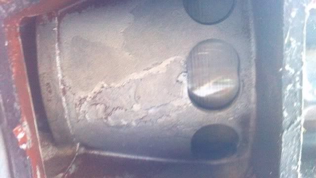

Well it looks like I might be better off finding a new block. I pulled the rest of the covers off and find something else I was concerned about. It looks like the aluminum is flaking away.

I guess my next question would be what years of blocks will work for the rest of my parts?

The 76-78 blocks use the older belcrank shifting mechanism. I'd stick with a 79 and newer to match up to your lower unit shift rod. Your original block is a low-port block, used on both the 150 and early 175 engines. If you find a flatback block from a 200, (1979 up through the 1984 185) they will also work. If you happen across a complete powerhead, such as a flatback 175/185/200, you might want to use those carbs instead of your 150 carbs.
