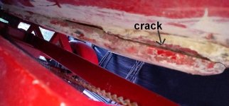

Hello, I have a homemade 14' boat and it is leaking water right now. I assume it is from the crack in my keel. The piece is lose, and I want any suggestions as to how to repair this. Should I go back to where ist is still firm and attached and make a cut to remove the piece and then make a new piece? Screw it in and epoxy it? There used to be a brass strip that ran up the front of the keel for protection but it got ripped off when taking my boat off the trailer.
Any help or insight would be great! Thanks.

Fiberglass is fixed by grinding out the damage and layering new glass over it, then bodyworking and paint. You won't know just how far the damage extends until you start. You'll also need to take the interior apart and check it out from the inside. Do that first.

looks like someone attempted to patch the crack from the outside with body putty
do you know if they used poly or epoxy? if poly, then you will need a few yards of CSM, a few yards of 1708 and a few gallons of resin. if epoxy, you need some light cloth, some 1700 and a few gallons of resin. in both cases, you will need ground fibers and cut fibers to make PB
the way I would repair the boat. pull the motor, seats and rigging, flip the boat over. grind back about 8" each side of the keel down to the wood, and feather the remainder of fiberglass back about another 8"
address the no-longer attached keel. this should have been glued and screwed. re-glue and re-screw.
PB the seam
start tabbing the keel from the outside. start 2" wide with 170X and go wider until you end up with 3 layers minimum. then a top layer of csm or cloth.
mix up some fairing and fair the surface.
paint or gel.
then from the inside, mix up some hairy PB and fill the gaps. use a masonry bag to pipe it in. smooth out the seams .
paint or gel

Csm = Chopped Strand Mat
PB = penut butter. Slang for thickened resin. You use cabosil to thicken the resin to the consistency of penut butter to fill small voids and attach wood to hull.
So your keel piece will be covered with purty, pressed onto the keel, screwed on, oozed out pb smoothed out, and glassed over.

upon inspection, wood from the keel is sticking out of the fiberglass all the way to the back.. from the rollers i'd imagine, and it feels like silicone was used. What a mess!
