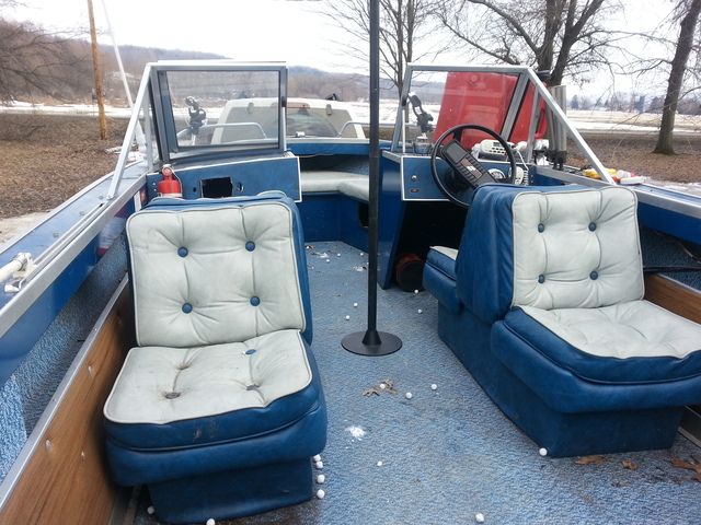

I picked up this old rig around March 2014 down in Buffalo, NY and hauled it back to Canada to become my first real fishing rig.
Here are some pictures of when I first got it.

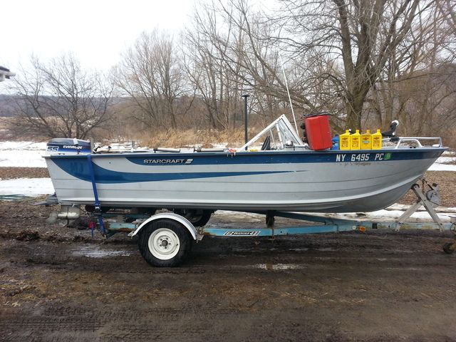

Here she is still down in Buffalo:
At this point, I dragged the boat home, and gave it a good cleaning out. I knew the floors were soft right away when I went to see the boat. I inspected the transom and everything looked pretty solid still surprisingly so I decided to just do some temporary things for last summer and enjoy the boat to get a better idea of how I wanted to rebuild it. I quickly pulled apart the front bench and replaced it with a carpeted casting deck and mounted a shiny new Motorguide Xi5 trolling motor on the front (who said you can't put lipstick on a pig?). I also put down some 1/2" plywood over the soft floors.

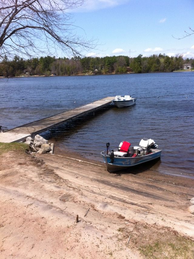

First splash, along with my first fishing rig. (12' tinner that I put a floor and the basics in haha)

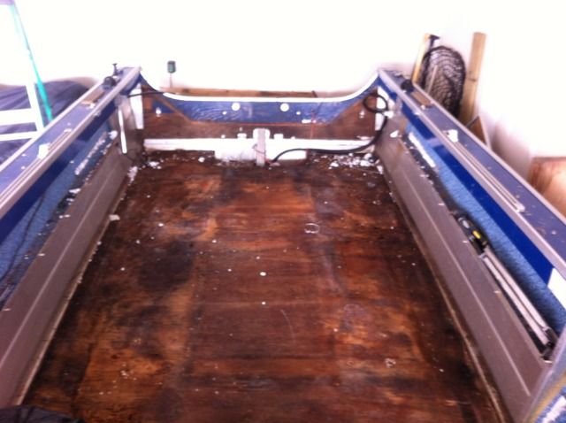

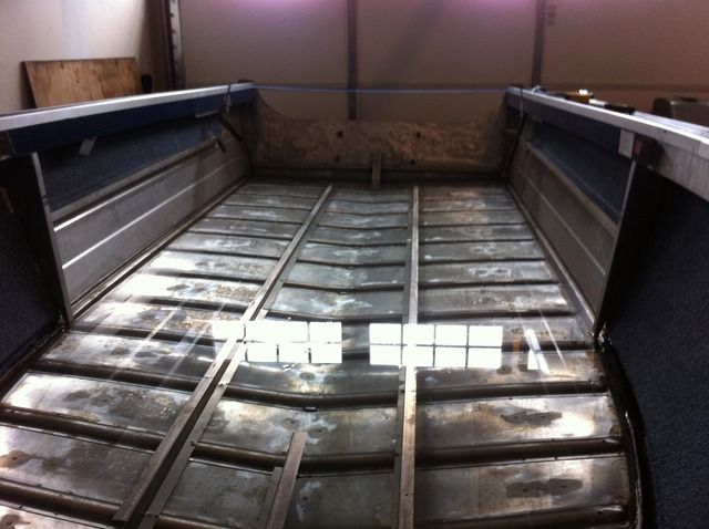

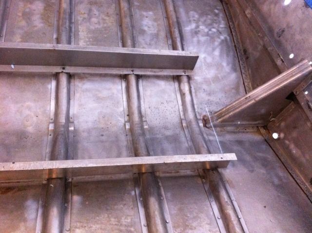

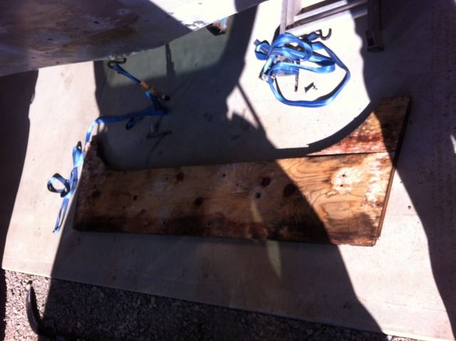

Floors were in tough shape:

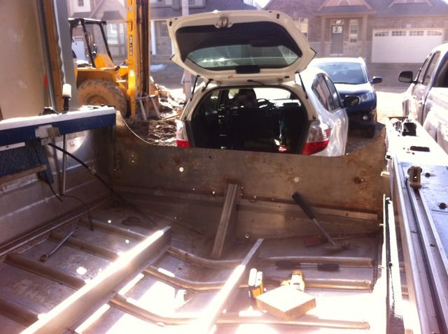

The transom however, was in decent shape. The splashwell had no cracks or signs of stress. Same goes for the knee brace.

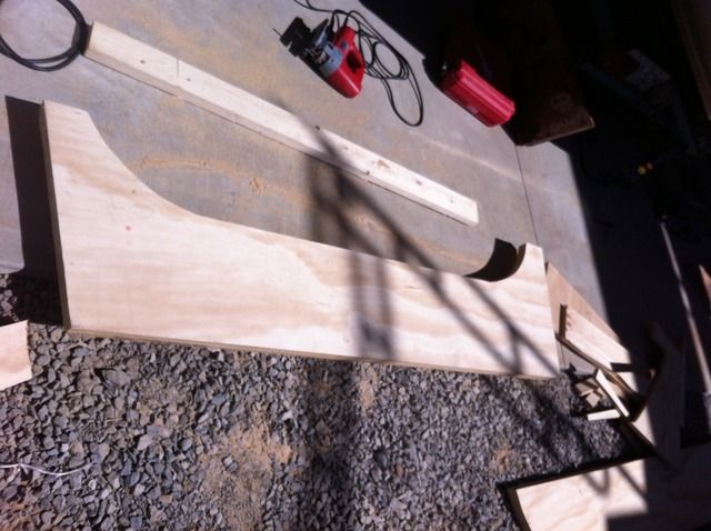

I used the 3/4" Arauco plywood for the floor and transom.

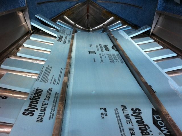

I had some help cutting the foam:
Just finished applying the Gluvit yesterday, I'm going to pull the foam back out and do a leak test today to see if I missed anything and then keep moving forward.

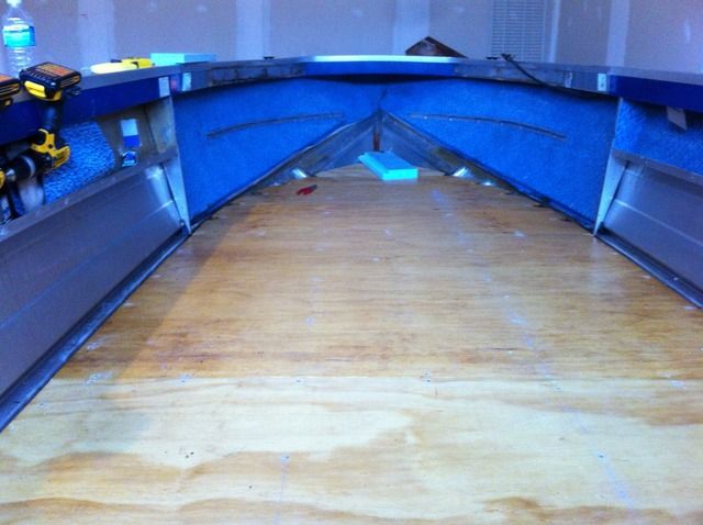

Ok time for an update.

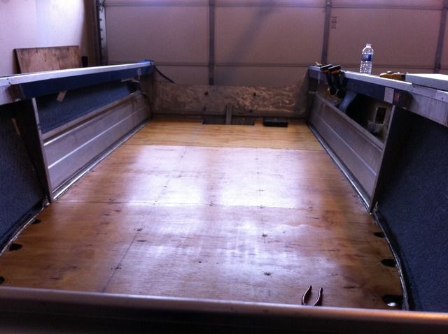

Leak test went well. No more drips :D !!! So I didn't waste any time and kept on moving forward.
I decided to go the time and cost effective route and used screws to put the floor down. They worked awesome and fast. I used SS screws at the back of the boat where it tends to see more moisture and then deck screws for the rest. With a quick pilot hole the screws sucked the floor boards down nice and tight.
I was thinking of maybe skimming each screw with a glob of 5200 to cover them up before I do carpet. Or would that be a waste?
Thats it for now.....I havn't come up with a game plan for the next step. Probably sorting out the transom and consoles. Oh and carpet. I was going to try and save that old vinyl that is on the hull but I decided to scrap it after reading that I can just use new contact cement over the old glue. :joyous:

Excellent progress on the SS! Glad to see you did a leak test while everything was out.
I have some concerns about the use of deck screws to hold the flooring down. I assume these are steel (carbon) screws as you said you had used stainless screws in the back area. When you do put vinyl or carpet down the protruding screws out the bottom will be exposed to a very high humidity environment. Even if they are zinc coated the moment they went into your pilot hole on the ribs the zinc coating likely got stripped off. It wont take long for the screws to rust, starting first with the threads that are the thinnest. They will then come loose and likely many will break off falling onto your foam. With time and vibration they will find a nice home to rust on your aluminum hull causing corrosion and pitting.
When I removed the foam on my 74 SS I found 5 or 6 steel mandrels from pop rivets that had completely rusted and was creating some very ugly pitting into my aluminum hull, with more time they would have certainly caused some holes in my hull. I used a small stainless steel wire wheel brush on a dremel tool to remove all the corrosion, then coat it with gluvit. BTW never use a steel carbon wire brush on aluminum boats, it will leave carbon deposits in the soft aluminum which will cause corrosion issues down the road.
Just my two cents on that part. Great job on the photos! Thanks for letting us tag along during the process.
Tnstratofam
Aug 18, 2013
2,679
Wow you are flying on your resto. I would use some 5200 or 4200 on the deck screws to help eliminate water intrusion into your nice new deck. Skimming the top of the screws may be sufficient, but walking back and forth across the deck combined with temperature changes could cause them to flex and break the skim coat. It may be extra work, but I would pull them out and then coat them and re install. By the way I know I'm a day late in saying so but :welcome:.
I wrote this same sort of post and deleted it before hitting post because you've already fastened the decking down so I didn't think it would be received as anything but negative feedback which most people don't care for. In the spirit of the iboats forum we are all here of our own free will offering help through out own expierences. Although some just regurgitate something they read and haven't been there or done that.
Anyway I agree with Wheeldriver and the way I see it, the best way to secure the decking on a SC is to the ribs is with large flange blind rivets. I guess I just don't want the next guy to come along down the road and read about using steel deck screws being a good choice to use because really they aren't the best choice for fastening decks, rather the cheapest.
If it were me and I made a mistake I would welcome input and expect the guys around here to set me straight. I hope you understand our motivation for wanting guys rebuilding these boats to know what works best. A thin strip of AL is all that's between us and an element that is not our own and can kill us.

Points taken guys, and I do appreciate it. I remember reading ezmobee's builds and seeing him use deck screws with good results which kind of helped me justify the decision. I'll certainly think this one over good through the week before I get back to slugging away on Friday. I'll price out some rivets tomorrow and see what its looking like.
Cheers !
