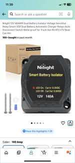

battery isolator that switches between charging starting battery and secondary battery
Dependent upon rpm, your motor is putting out 5-50 amps per hour of run time.
Given the small output and the use of a AGM, I would go with a charge relay over an isolator
