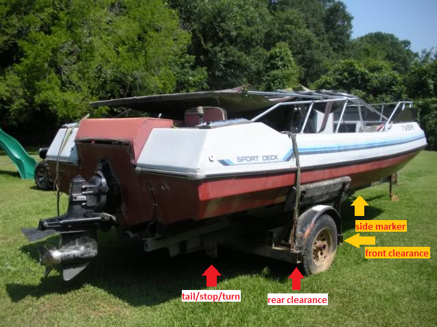

My old boat trailer only had one set of tail/brake/turn signal lights when I got it. Their placement is no where near the sides or rear of the trailer. There is no clearance or side marker lights.
For the lighting requirements, I'm looking at these two sites:
Federal Lighting Equipment Location Requirements for Boat Trailers
Trailer Light Guide
Being that the trailer is wider than 80", it seems as though I'm missing several of the required lights, including front side marker lamps, and front/rear clearance lamps.
With the current placement of the tail/stop/blinker lights, do you guys think I should leave them where they are, or move them to the outside of the trailer so they can serve as the rear clearance markers as well? I hate to move them because the [new] wires won't be long enough. Can I get away with leaving them in the current location and adding some rear red clearance lights?
Also, I don't have any suitable mounting location for the required (3) lights in the rear middle. What would you guys recommend for that?
Here is what I'm working with, and the locations I need to add lights. Does this seem right? (This is the trailer/boat when I first dragged it home, it looks a lot different now!)

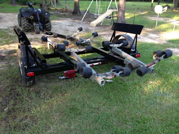

I decided to keep the tail lights in their existing location, at least for now. I added (2) rear outside clearance lights (red), a 3-lens center light on the rear (for trailers over 80")(red), (2) front side clearance lights (amber), and (2) side lights about 6 feet back from the hitch coupler (amber). This seems to meet the requirements for my trailer, so hopefully there won't be any problems. I also have a couple amber and red reflectors I'm going to add, just to really make this thing visible at night (if we ever haul it at night). I'm also considering putting a couple reflectors on the rear of the boat, since it hangs so far past the rear end of the trailer where the lights are. I just don't want that to look silly on the boat.. I haven't tried it yet.

IMO, those little ovals like you have on the trailer don't look bad when placed high on the boat transom.
dccordell
Apr 28, 2010
415
Re: Correct placement of trailer lights
That's what I was thinking. Those ovals on the trailer are actually lights, but I have some that are just reflectors in the same oval shape that I may attach to the transom. Either that, or get some of that red reflective tape and put a strip along the back there.

I would have moved teh combination lights outboard to where you put the marker lights. The hull really blocks them where they are.
Thalasso
Jan 18, 2011
2,879
Now that i look at the pic again, you have the marker lights in the wrong place. They should be on the sides. Around from where they are now and the brake lights where the marker lights are.If i see the brake lights right, they already have side marker lights on them. If this is so you can get rid of the ones on the back and move the brake lights there
dccordell
Apr 28, 2010
415
Thalasso, I think you're right.. I should move those brake lights to the outside. I'll have to get on that. I'm glad I have plenty of extra wire... :rolleyes:
