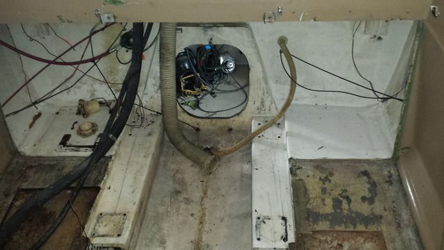

I was absolutely going to have to change the transom keyhole because my boat was rigged with the OMC Stringer. The keyhole for the Stringer is just a massive hole in the transom that the outdrive sticks through(outdrive mounts to the motor and doesn't actually mount to the transom at all).
Here's a picture of the OMC Stringer transom for my boat:
Here's a picture of a Mercruiser keyhole:
