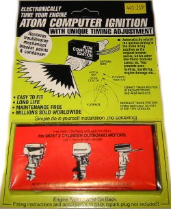

please let us know., what part number for the module? i too am following this post. i have several motors running on single lines. this module interests me :). the points are great and simple, but i do like tinkering...

Is this the module?

i personally cant attribute the lack of smoke to the modules ( they do advertise multiple spark per ignition ignition cycle for better combustion). have never ran this motor using points. i do agree with Chris on the oil quality. i try to avoid the cheap stuff, and cant afford the high end synthetics! lol
