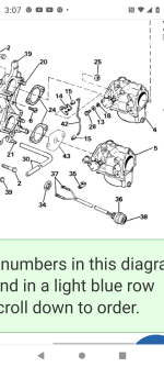

Part number 36. You might also need 38 and 34 unless you can save the old one.
