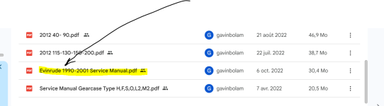

Crosbyman
Nov 5, 2006
6,260
download you service manual from this list... pretty sure it covers testing the display if not well the file will be usefull for other things. the display is pretty much still used on medern etec evinrude engines. if the suggested manual does not cover testing the dispaly by grounding individual wires pull up the 2007 75hp manual it has a section to "turn on" each led.... but it looks like your display is self testing properly at key on.
TnTommy
Oct 12, 2025
102
Ok thanks
