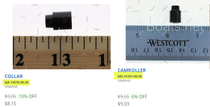

Small update. I found the roller labeled on another parts site in the carb section schematic. On there it is called "Collar and stopper set" with a current part number of 99999-03499-00 and a superceded part number 6L2-14578-00-00. It's a hefty $38 there and maybe a few bucks cheaper other places...still about $40 shipped though.
The 682-41291-00-00 roller I had originally found was listed as less than $10. Sizes seem pretty comparable per the images above and below. I still plan to check with my dealer in the hopes they can help but wanted to follow up with at least what appearsto be the correct part number per the carb diagram. Thanks for the help.

Bumping this thread because I found a cheaper solution.
After I posted this, I made do by swapping a good roller from another similar year motor onto this one. I still needed a few rollers though as I have 3 of these in my shop to fix up, all with worn rollers, and I just sold the one with the one good roller on it. I noticed my 1988 30hp 3cyl roller looked similar and that it could perhaps use replacing as well. Looking it up, it was an $8 part....so I ordered it to try on the 25hp and if it didnt work then I would just have a new one for the 30hp so it wouldnt be a waste. It arrived this weekend after an 8 week backorder delay and thankfully it fit the 25hp just fine. Looks like the exact same part, it's just all black as opposed to the original white one. Anyways the part number was 6J8-14578-00. Hopefully this helps some others save a few bucks. It certainly will help me in that regard.
