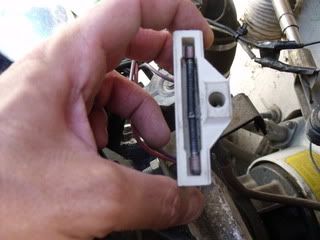

Can somebody tell me what this is????PLEASE

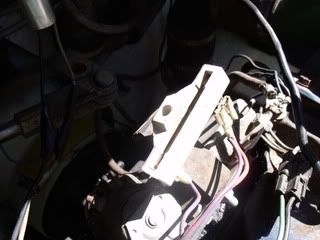

1976 Thompson 302 Ford - Need to know what this thing is..its attached to the motor and has 3 wires going to it.left side 1 wire right side 2 wires and gets hot if i leave the key turned on to long.Its ceramic and has a coiled wire with solid material inside,well its must have got too hot and the coil split in the center.Please help none of my dash lights or blower is working and have plans to watch fireworks on the lake with the family tonight.

It is a balast resistor. It limits volvtage.. Usually goes to the points in the distibutor, I believe to reduce voltage to around 9V
That is for sure what it is ... If you converted to electronic ignition like I have .. it is not needed ...

by the way ... you can get them at any auto parts store .. they are pretty much universal ... Happy 4th !

I wish I saw this post earlier, that's what it is all right. I had the same thing in my 1974 Plymouth 'Cuda, The damn thing stopped running one day, everything worked- cranked over, lights, radio, just would not start. A buddy of mine said did I check the balist resistor & sure enough it had poped like a fuse. Swapped it out, fired right up. Always had an extra in the glovebox just in case..Sorry to catch post so late.

The key is you said it gets hot with the engine off. The only way to make heat with electricity is through resistance.

It's a ballast resistor.It reduces voltage.It is probably used to reduce your battery voltage down 3 or 4 volts for your ignition coil. From looking at the little curled wire inside,it appears that your ballast resistor is burned up.
I too used to drive old Mopars,always carried a spare resistor or 2 in the glove box,like exeddog said.
