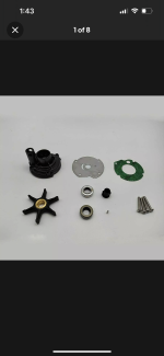

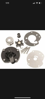

Hi everyone, I picked up a 1967 evinrude 9.5 and it needs a new impeller. Could I use this 6hp kit on the left in replace of the stock kit on the right?

Driveshaft is different diameter.--The 6 is 0.437" and 9.5 is 0.550" going from memory.------Nothing wrong with the 9.5 impeller / water pump set-up.----Contact ---evinrudeparts.ca-----for factory ( good ) parts.----I have put bad pump housings in a 4 jaw chuck on a lathe to return them to factory new condition !
