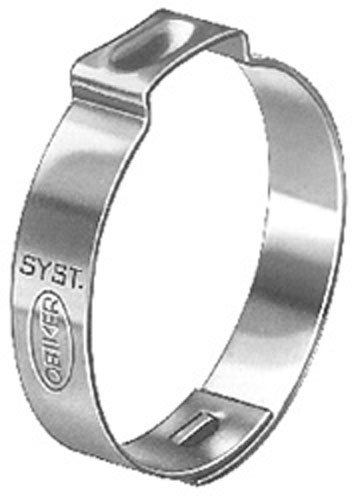

Yes use good zip ties and a good zip tie gun to install them. There are other really good clamps as well, crimp type hose clamps work really well and don't take up much space.
If you can install them, they are solid. JMHO!
