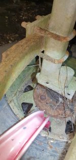

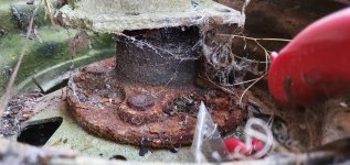

I have a Bayliner Capri which now lives it's life on the South Coast in the UK. Its trailer is your good old fashioned American curved galvanised single axle.
It has lived down my sideway for some time now because in the UK, trailers over 750kg gross weight have to have an inertia/over-run/surge braking system. Getting an inertia hitch is fine but, I wondered if anyone can tell me if these trailers were also designed to take braked hubs? If so, it's a straight swap for braked hubs, change of hitch and, brake cables.
Can anyone let me know the correct size hubs? All I know is they must be 5 stud and 112 PCD.
Here's photos of my trailer and the current un-braked hubs:

Suggest disc over drums
Bracket and caliper mount to the standard holes shown
Disc just sandwiches
Or if you go drums, backing plate bolta to holes shown, drum replaces hub

Unfortunately discs aren't allowed in the UK - trailers have to be able to brake themselves so, it's cable drum braking only, with handbrake cables and an old fashioned parking brake.
There's a choice of 200mm/8in or 250mm/10in diameter and 40mm/1.5in or 50mm/2in. Which thickness do I need and what's the offset of the wheels?
52,428
I don't think there are over-run/inertia/surge brakes with backing plates but, Trailer hubs, yes. In the UK, there's a choice of 200mm/8in or 250mm/10in diameter and 40mm/1.5in or 50mm/2in. Which thickness do I need and what's the offset of the wheels?

Ah so I guess yours are required to have a parking brake so that leaves out disc brakes; although disc can be made with a small internal parking brake but I’ve never seen that on trailer disc brakes only on vehicle brakes. If that’s the case I’d try to use galvanized 10” drum brakes. The wheels I ‘think’ are zero offset. I have used 10” galvanized hydraulic surge drums and I got pretty good life out of them; I usually just changed the whole backing plates after about 5 seasons. I recently upgraded from a 2x2 3500 axle to a 2x3 6000 lb axle with 12” galvanized drum brakes; with this it stops great and no drag due to the strong return springs of drum brakes and being able to set the manual adjustment for no drag,

Looking at the backing plates that are available in the EU it looks to me that you'd have to replace the whole axle, I don't think that their drum backing plate assemblies can bolt up to a US spec axle.
