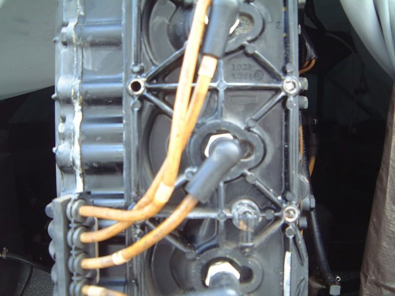

I broke a blot that holds the water jacket cover on, I am sure more will break. So do I just keep using the socket or is there a tool that I can get that might reduce the number of breaks? The one that broke was white on the threads, I am asuming due to water, which made it brittle.
Then use a tap and die to get the broken ones out, correct?
TIA,
Eric

Well I tried all of the above and most of them broke only got 5 out and they were very rusted. Now I have to try and drill them out I guess. I'm afraid of the drill getting into the alum cover.
Any idea's on how to get them out with out drilling?

The cover won't come off. It looks like the gasket failed around the whole cover, I see white deposits on it. Would heat loosen this up?
