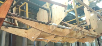

Here are a few photos from a Sea Ray factory tour of about 7 years ago (2018 ish) . . . Still using wood. Looks like a mid-size Sundancer hull . . .
Stringer & bulkhead grid

I think you will find something similar on the other boats you are considering.
So, be sure what the boat is made of . . . not just from what you read somewhere. Verify from factory sources (product brochures, factory videos, etc.).
