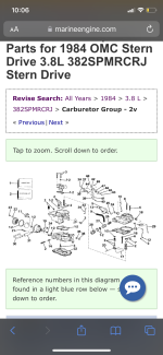

Maybe the float adjustment or accelerator pump…?
At 2K rpm I was able to drive and drive, but slowly. At 4k rpm it would last for about 30 seconds and die.
My theory is that the float bowl couldn’t fill up fast enough at 4k…?
Thanks.

Could be a Restriction somewhere in the Fuel System, including Tank Venting, Fuel Pickup in the tank, even a weak fuel pump. Have you tested the Pump for Flow and Pressure? Is there a Filter at the Carb? Is it a 2bbl or a 4bbl?
Serf27
Aug 23, 2018
167
i have not looked at the fuel vent. That did also cross my mind but I never checked it out.
I was able to pump fuel out of the tank relatively easily though from the main line that goes to the pump. I felt no restrictions there when pumping old fuel out. It flowed in a steady stream.
There is a filter on the carb, it is new.
I have not checked the pump/pressure either.
When the pump line was disconnected from the carb and I cranked the engine, fuel would not shoot out in a steady stream, more like pulses.
I figured this was due to because the engine was only cranking or it was a normal amount, enough to fill the bowl.
I am not sure now.
It is a 2 bbl.
