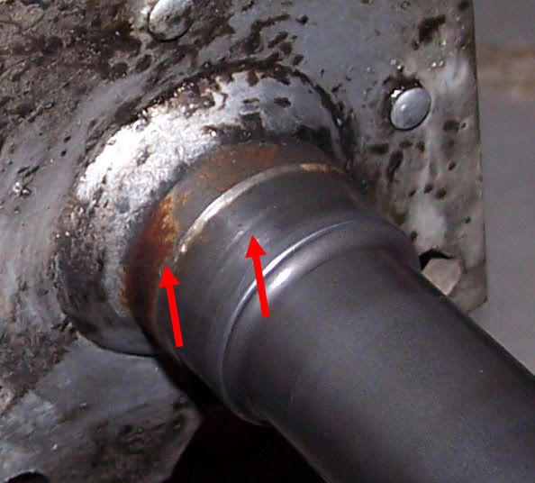

I am re-packing wheel bearings and while I don't think I need to replace anything except the seals, I would like some opinions regarding the condition of my axles and bearings to confirm what I am seeing.​
Right axle:
This axle looks pretty good. (I think) I see a very light ring where the seal rides on the axle but I think this is probably normal. It also has some surface rust behind where the axle rides. (This is a used trailer I just bought...it is 15 years old but wasn't used heavily.)

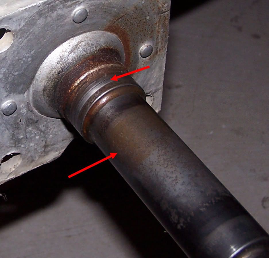

Left axle:
The left axle has some light pitting or scaring on the top half of the axle but doesn't seem to be where the bearings ride. My feeling is that I should be ok if the hub is packed with grease. This side also has a line on the axle where the seal rides. I can't snag my fingernail when I run it across this area but it does seem to stand out in the photo. Is this normal?​

If you were told the trailer was used very little you were lied to. The groove where the seal rides is not normal. There should be no groove there. Any marks of any kind on a bearing or the race means it needs replacing. Never run a new bearing on an old race. it is counter-productive and invites early failure. Bearings are cheap and any auto suppy store can press the races for a couple of bucks. Do not be surprised if the seals on both sides leak and sling grease on the inside of the wheel due to the grooves in the spindle. Properly pack the bearings and when you install them make sure they are adjusted properly. Lastly -- the hubs and spindles have had moisture in them and that accounts for the pitting. It's called lack of maintenance.

So are you saying that the groove in the spindles where the seal rides should be cause for a replacement or just live with the idea that I may leak some grease? Is there anything I can do with this spindle to solve or minimize the problem? Would something like this be beneficial?​

they say they are, emery cloth and clean up the spindle. then make sure they are clean, before grease.

In the Top picture,.... I'd polish the area where the Seal rides with 220gt. emerycloth,+ Put it back together.....
In the 2nd picture,... I'd polish the Seal area again, along with the rest of the quill, just to clean off the Rust.....
If you can't Feel the little score caused by the Seal,..... I wouldn't bother with a Speedisleeve,....
Not unless the score is more than say .015 or so......

tommays....Thanks for the photos of the speedi sleeves. I cleaned everything up with some emery cloth and it looks much better so I think I will try without them this time. I'll keep an eye on it to make sure I'm not getting anything leaking out the back. I'll pull it apart next winter and see how everything held up and then go from there.​
