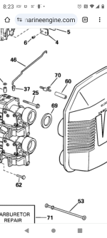

I made a separate post about how the engine is running. New spark plugs may have cured that problem. I will know for sure when I can run it under load. But, I disconnected some hoses, while troubleshooting. I took photos of the hose connections before disconnecting the hoses. But, the photos didn't capture everything. I am confused about the balance tube manifold hoses. The starboard side hose goes in to a hose nipple that is in the crankcase. But, I am not sure where the port side balancer tube is connected to. It looks like it was routed either to a "T", or to the air silencer. I do not understand why the port side balancer tube would go to a different place than the starboard side balancer tube.
saltchuckmatt
Jul 19, 2019
3,401
I'm going to say it goes to both but it's an educated guess.
