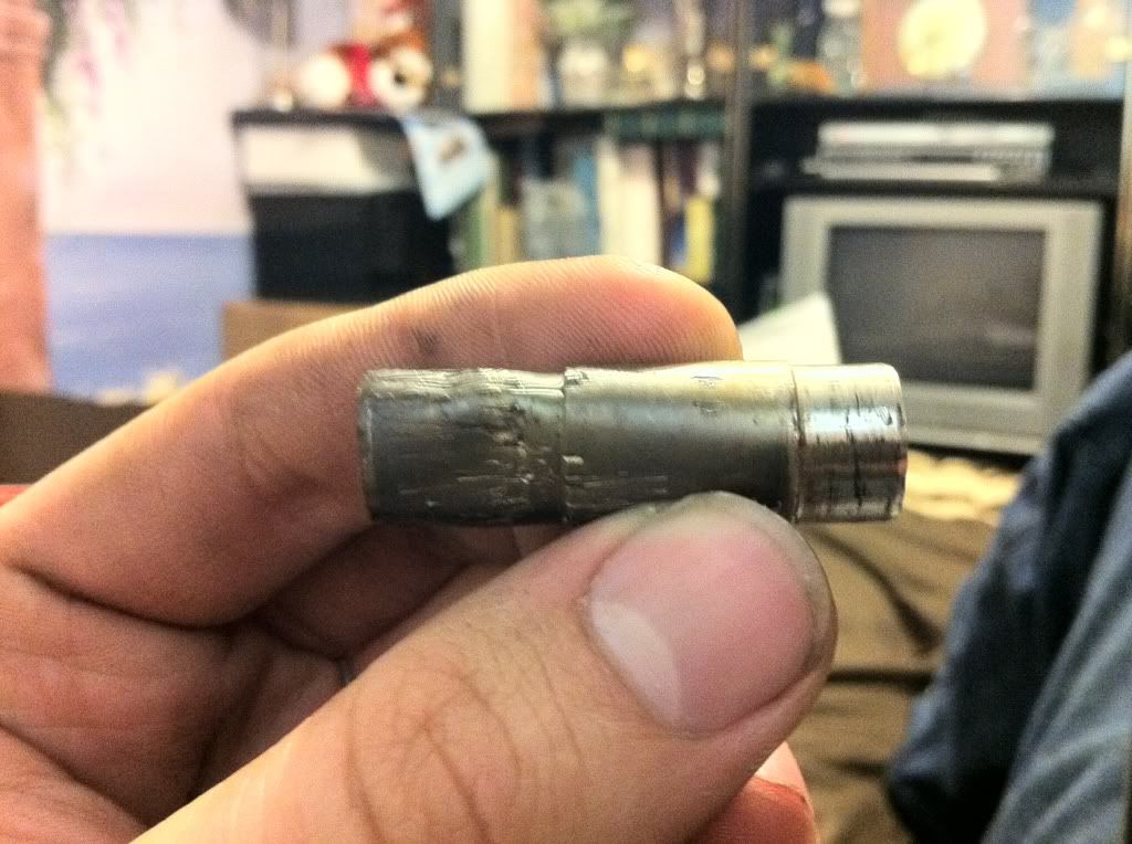

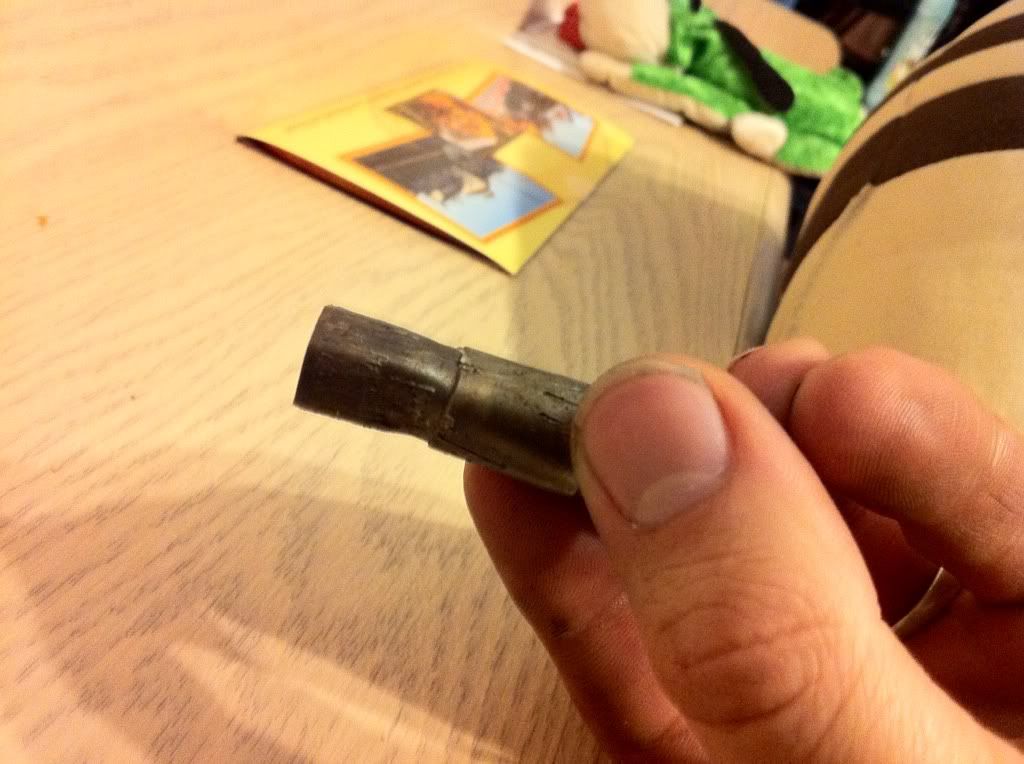

So i went ahead and pulled out the old tube... it took a lot of pursuation... but i got it out... i really chewed it up... :( but the tube was also clogged.. which would probably have contributed to overheating or something.. here are pictures of the old tube from the old head.

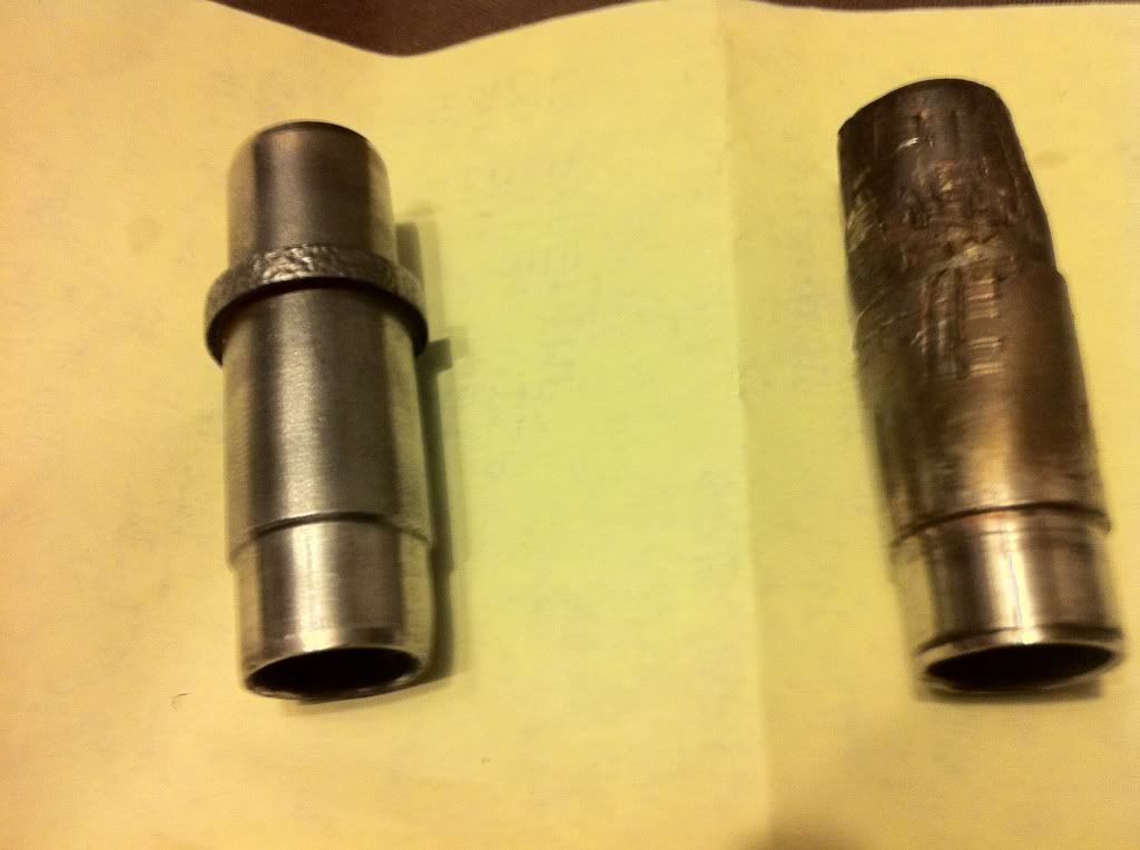

Gentlemen. So i have figured out what happened to my Oring Flange.... Appearently the Little Flange that sits on this tube to hold the Oring up is actually a different material than the copper or brass. and when the head was hot tanked.. it in turn took away that flange.. leaving me a naked tube...
So i just received my New tube (slightly Used from a Local Marina shop in tacoma, wa ) and here are the pics!! i love it... it looks so nice i cant wait to stick it in its proper place... no need to jimmy rig it now.
