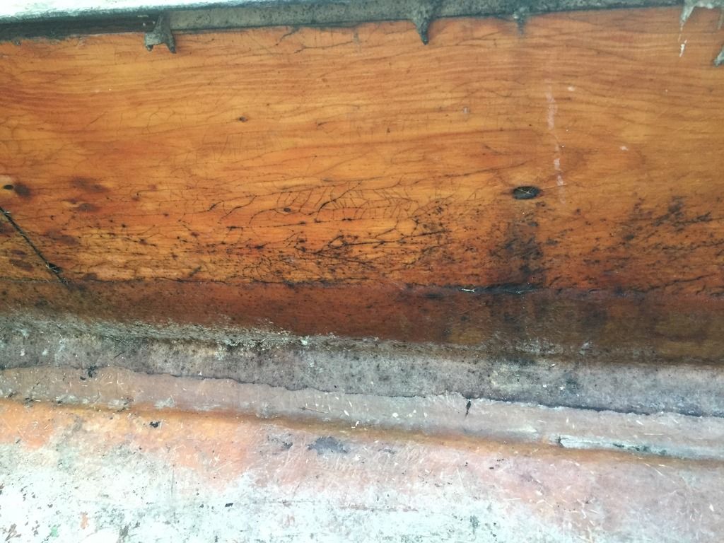

Has anyone used the garelick SS toggles to hold their pedestal bases down? I am taking out a back to back and installing a captains chair. I brought this up a few weeks ago but didn't hear much about toggles. Back to back came right out, was just screwed into the floor in 6 places. I can see under the deck on the drivers seat and it is nut bolted and washered through the deck, plain and simple. It still feels solid after 20 years.
Or I could cut a hole out with a hole saw into this stringer to give me access under the deck and do nuts bolts and washers instead. Then epoxy and glass the cutout back into the stringer. Probably not the best idea............

Or you could do this, which would be my recommendation. That way you could use T-Nuts on this base and then glass it to your deck. This would ensure good stability and strength.

Thanks for the reply wood. When we were talking about this last month you were repping the same protocol. My only three issues with this is 1. It won't match the other side, 2. The paint won't match the rest of the boat, and lastly it will be very time consuming. IMAP about doing a good job but if I can add a nice thick backer plate under the deck wouldn't that be solid enough? If I cut a hole big enough to get my hand through the stringer to work under the seat base and then re-epoxy and glass the stringer would that be a solid option?
Am I asking for failure to just use these toggles for what they are designed to do?

I suppose you could reverse the process and cut an access slot in the stringer to slide a 3/4" plywood plate under the deck and use PB and Screws to hold it in place. It wouldn't weaken the Stringer significantly to do that. Mike is correct about the hole size for the toggles but they do work well and filling the holes isn't that much of an issue. With 1 1/2" of Plywood you should have more than enuf strength for your "Big Boy" friends. I'd Recommend a 18" x 18" plate and I'd make sure and get plenty of PB on it and pre-drill the holes and coat the screws with PB too!!! If you do the install correctly it should stand the test of time and the abuse of your passengers!!!;)

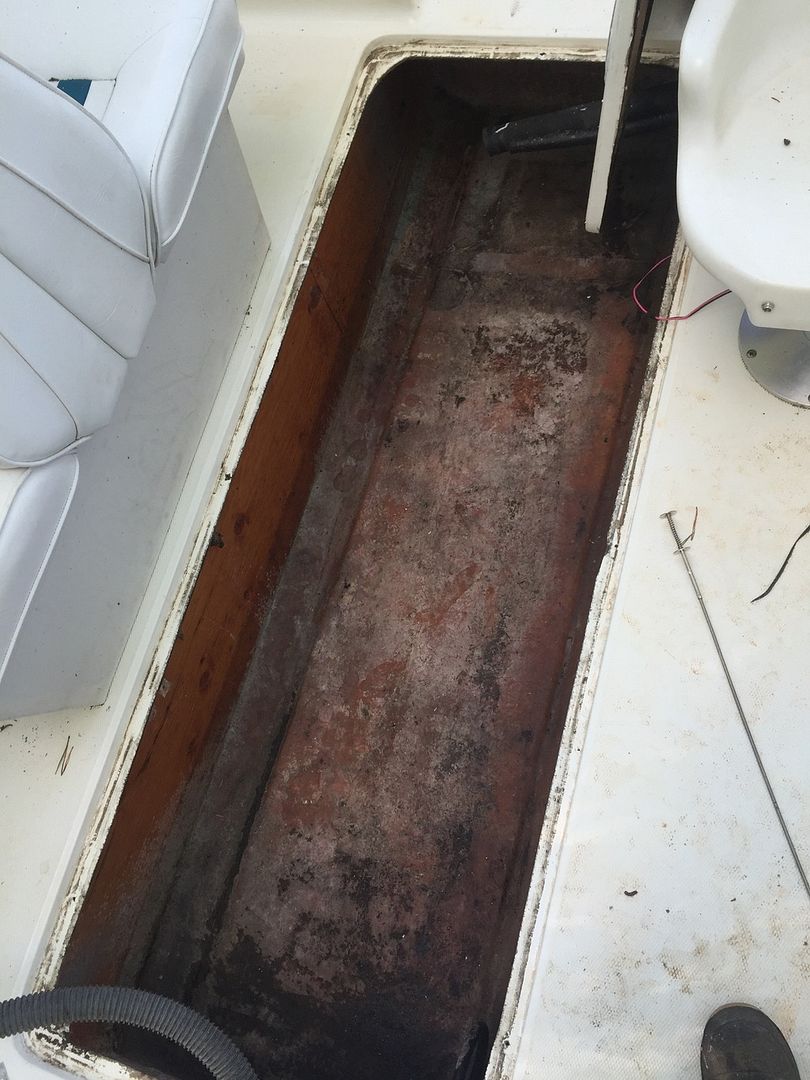

4,089
Pulled the fuel hatch again. That side is filled with flotation foam so I am not sure how worth it it is to try and get under there. You can see under the drivers pedestal, and the dealer used small washers with nuts. Looks like it would be even less stable than those togglers would be. Man what the heck were they thinking??
