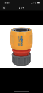

I’m guessing this is the port ?
That actually is the same as mine. It’s the standard garden hose female fitting that goes on there. Quick connect thing. Or it is where I am anyway. See picture below that goes onto the hose and the quick connect snaps onto that fitting on the engine.

I’ve tried two diff types nether pass water like the fitting is blocked on the outboard, there’s a valve fixture in the outboard fitting, tried air pressure which pressurized the motor and air escaped the fitting if the plugger valve was displaced in the fixture …. Very weird

See that fitting there you have. The male hose quick connect. For certain, you will get a female connector on there…but I have a feeling that that fitting you have there, may have been fitted additionally by someone previously perhaps. It may well unscrew from a thread there. Leaving you with the hose fitting thread that you may be more familiar with, in your area perhaps. Lots of info on it online or YouTube. Not something I’d usually steer anyone towards..but mercury themselves have a few videos on this very subject. You need to make sure the engine is tilted down and the engine should not be started when using this method. It’s designed specifically for flushing without running the engine.

If you unscrew that connector you will for sure find threads, either NPT or garden hose, from the looks probably 3/4” NPT or 3/4” Hose. Like stated someone had their favorite flavor of quick disconnect threaded in there, I do that on mine too (‘06 Merc 90hp, except my port is on the back of the midsection)
