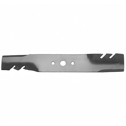

For $14 a blade I buy new Gator blades every 3 years. :)
They love to chew threw rocks. :eek:
Cofe
Apr 23, 2009
1,883
Re: any tips or tricks for grass cutting deck
I agree with Summer Fun. The gator blades are GREAT. I get the ones made by Oregon on Ebay.
