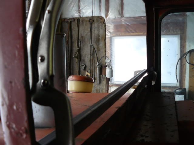

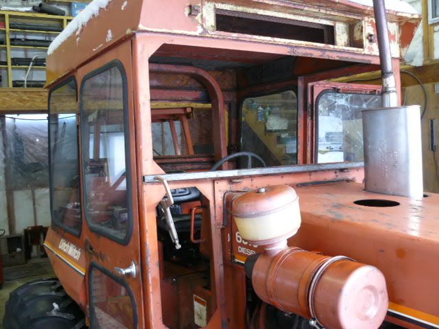

Ok so here is the cab I picked up for the ditch witch, as can be seen by the pics it had a bit of a run in with whatever the heck and got a bit twisted.
So now I am going to attempt to straighten it by first streching it out to were it should be.
Any thoughts???

In the second picture it looks like the "A" pillar is bent back too. I would word on that pillar then across the windshield area. That windshiel area would be a fairly easy fix to draw forward.
With a few turn buckles, a welder, and some steel that should be easy. If I were closer I would do that ;)

I'd be taken that other glass out first.
2x4's on the inside pushing it all back out, use the rollbar as the push agaisnt spot.
Then use some sq tube or angle iron welded in under the windshield.

Cut the back leg of the angle all the way to the front leg. Pull it out then weld it back up. It might take several cuts to get it straight.

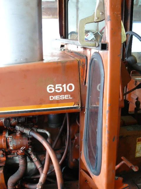

Just came back from lockin up the shop (-15c in my t shirt, MORON) anyways the vertical post in picture is twisted, I think I can take the monkey wrench and twist it back straight.
As for the streching it back straight across the top I went and borrowed my neighbours old school 3 foot jack with the worm gear, I will block that into a horizontal position and apply some preasure, and see what happens.
