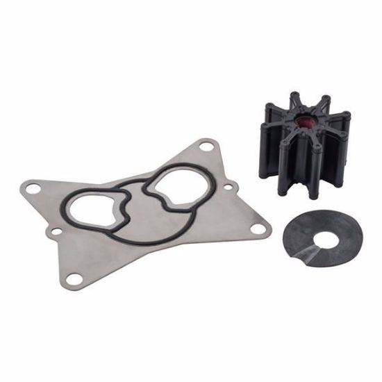

thanks guys. The impeller i took a pic of i bought from a boat dealer locally. Had to give them the engine serial number and i probably should have checked the number that was stamped on it.
But....Good news!! (and some not so good, but not really bad i guess)
First, it appears my overheating issue is now resolved. Replaced the entire RWP with another new VP unit (surprised its not painted, but that's for some other time) and finally took it to the ramp this evening. idled and watched temp climb then drop (t-stat opened), then climbed again and settled about an 1/8th of inch to the left of 175 (see attachment). So, took it off the trailer and went and ran it hard for about a 1/2 mile. Needle climbed to between 1 and 7 in 175 then dropped a little. Stopped and idled out of gear for a bit. Normally, it would start to climb and die out once it went right of the 175 mark. this time, needle settled just to the left of 175 and stayed. Ran it hard again for 1/2 mile then went to launch and trailered. While on the trailer (in the water of course), let it idle for a while. again, prior runs it would pass 175 and shutdown. But like on the water, it settled to the left of 175 and did a little 1/16" deflection as stated above. I swear the temps were lower prior to t-stat change, but i think it was a 130 t-stat (it was hard to make out the middle number). The new one is a 150 tstat.

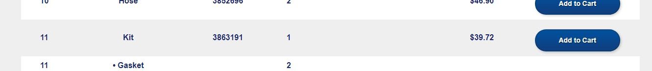

I hate to ask in this thread since this is Riser related now, is this a valid part number for the gaskets? MarinePartsEurope says for the GXI-E the part number is 3863191 but it also says the gasket is out of production?

That's what I have on my desk
