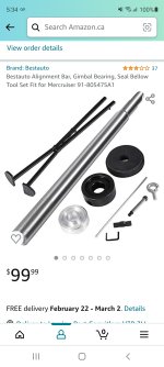

I am unsure about that small straight piece. My drive isn't alpha 2 drive so will these work. I have purchased the bellows kit and it came with bearing as well
Small straight round stock is used with bellow expander tool (upper left in pic u attached ) to expand and hold in place the exhaust bellows to bell housing. The small rod goes through the bellows expander and holds the tool in the exhaust port of the bell housing while expanding the bellows to stretch the exhaust bellows into place so you can glue and clamp it. Probably you tube videos of bellows replacement where u will see this in use.
