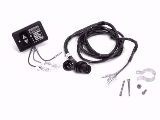

This looks to be the same as what WM has on their website, but unsure of the quality of this one.
