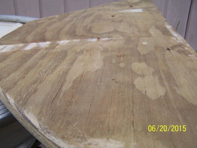

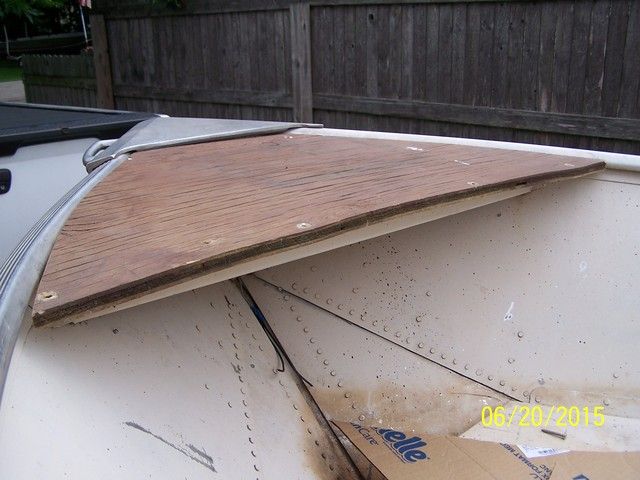

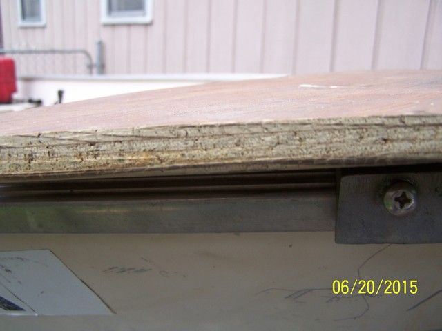

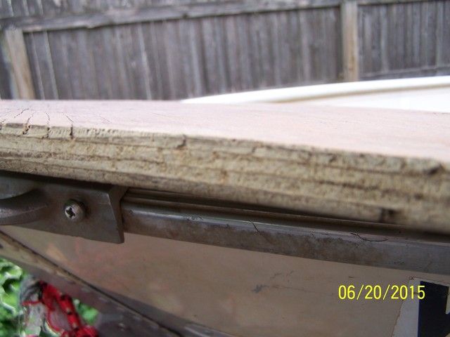

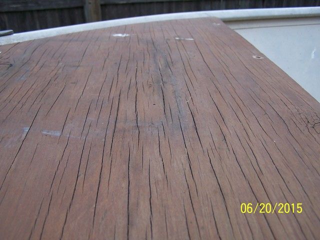

So after seeing this I don't think I'm going to worry too much about being caught out in the rain and being wet for a couple days.
I really do not believe that was marine ply. For one I don't think it would have checked as much as it did and secondly I've look before at marine plt and everything I've seen has been 5 ply's or better.
Anyway, I've finally got that pc. fitted for the bow and I think I'm just going to sand, fill and paint it for now. I'll try and get a few pictures of this pc and show the checking and sawed ends.

That looks like pressure treated plywood to me, not something I'd want in my tinny... and probably why it has lasted with nothing but checking.
Most probably is which is another reason why it's all coming out.

I agree that looks to be PT ply, certainly not marine grade, even 1/2" marine ply is 5 layer. 3/4 marine is 7 layer. I think I would be tossing that piece off the SN quite a distance if it is PT ply.

Agreed not a good idea to use though I will as a temp until I finish the Alumacraft. Most likely only till the end of summer then it will be done properly. I've also got some old rubber 1/8" gasket sheets that I plan in putting in between the wood and the boat for now.
