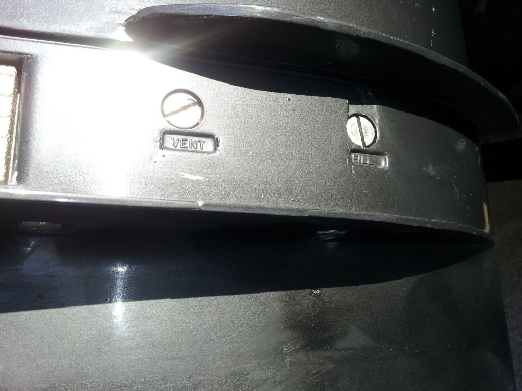

Hi guys, my second post now about my new to me boat with another question on a small leak I've noticed in my driveway now. It's leaking what looks to be oil of some kind? It's much thinner than motor oil, but I'm not sure what it could be from? It's coming from the weep holes under the fill/vent screws on the lower part of the motor... Pictures below, how concerned should I be?

Probably unburned gas/oil.
When you tilt the motor it sometimes leaks gas out the carb.
It finds its way to the bottom and out the weep holes.
