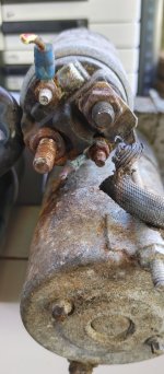

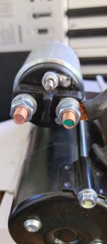

I am replacing my starter on my 4.3lx Mercruiser engine and the solenoid on the starter doesn't have two little posts like my old one did, does that matters? I was just going to put them purple and yellow wires on the same little post on the new starter.
I have attached a photo of both starter solenoids old and new.
Everything else in the new starter looks the same.

Yes it matters. Your old starter was designed for use with an electric fuel pump. The new one does not have this feature.

Thanks for the information before I installed it and found out the hard way. I will return this one and order a new one.

Ayuh,..... His pictures appear to be the little starters,......
I Love 'em,.... 1/2 the weight, 'n darn near twice the power,....
Definitely need the other tiny post for a fuel pump,....
You can run the fuel pump lead from the slave ...

I switched the solenoid and ended up putting the starter in. It's working great, now to figure out why it's so hard to start for the first time.
