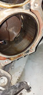

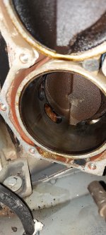

That said I got a fiberglass bass boat and had to rebuild it from the hull up. Got a johnson v4 crossflow 90hp on it and life was great. Until it wasn't. Long story short I had 2 pistons that I have to replace. Bores cleaned up to with in spec. I have a 140 hp engine for parts. Block was junk.

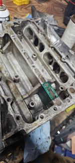

Jan 17, 2019
963
That green area is what you'd need to drill or mill out for the bubbleback. But has anyone ignored that? id think it wouldn't hurt much as it divides the bubble back exhaust better for more exit velocity vs. being open but I dunno. BTW this is an XP/GT 100 that has the 140 ports.

I have been all across the interwebs, and it seems to be a hot debate with regards to the bubble back exhaust system. Some say cut the web out, some say don't. Some say the stuffers are a nessety and some say it will give a little more rpm. Still on the fence about wich way to go.
As for my build I am just squaring the 90hp ports and going to add spacers behind reed plats to reduce Crankcase Volume. It does have intake stuffers and I will leave them in. Going to use the tighter heads from the 140 hp. I am going with the bubble back exhaust, just unsure whether I will use the stuffer or not. I will mill the web at the bottom out how ever. As for the Carbs, the 90 had the larger carbs on it. How ever the high speed jets were from who knows where or what. They are numbered as 29. Can't find those sizes for omc. Looks like I will go with the 140 carbs. Also as I am getting things cleaned up and looking closer at what the previous owner /s have done on it. Found base gasket was leaking, exhaust gasket was leaking water, wich cooked 2 cylinders. Also timing was at 20 degrees at wot and spark plugs were 2 heat ranges to low. Surprisingly she still had 100 psi on 3 cylinders and 95 on the beter of the two bad cylinders. She started and ran well. Or so I thought. Started investigating because she developed preignition. I noticed some water under the exhaust cover plate so figured I would change the gasket to be safe. And the I found the damage. These motors are impressive on how well they can run when actually near death. 20260516_152131.jpg20260516_152054.jpg
