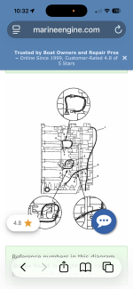

What exactly is this system do. Off disconnected does it effect runability
Honorary Supreme Mariner
39,973
It recirculates oil.-----You should NOT disconnect any of it.
Gizmoray
Recruit
Jul 15, 2026
5
I was replacing my starter and found both lines were hanging disconnected. The oil injection system had been deleted befor I bought the boat.
39,973
Sorry---Oil injection system has nothing to do with the bleed system----Hurry to a boat shop and have it checked out and installed correctly.
Gizmoray
Recruit
Jul 15, 2026
5
I was able to reconnect them both. Have had the boat for just over a year, always wondered why the motor always had oil on the one side
