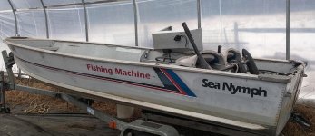

I had total motor failure on the Johnson 25 a while back, and rather put a newly rebuilt motor on my hard luck body, I did a resto on the Sea Nymph and afterwards starting feeling what I believe is a propeller issue. Those pics to follow.

I wonder if someone could verify if this is the correct propeller ( 13-11)for this motor or whether its condition would cause me issues. The boat just doesn't "sound" right as it cuts a wake, kind of a warbley sound and a bit more engine movement than I think it should have. I know one of my motor mounts is starting to give up, so I may be experiencing a confluence of issues.
It's most noticeable at half throttle and below, top speed is not effected, I can top at about 24, and boat planes out fine. Any advice?

Excellent, thank you. So the "warbling" I hear is likely caused by cavitation from the increased diameter?
In selecting "load", other than choosing for the max RPM, how does one calculate that? Seeing the type of boat above and the load being generally me (215lbs) and my kids+ maybe another 240lbs, would you think the spec you referenced suitable (10x11)?

A good thought, I did drop the prop closer to the transom as I was having a difficult time planing out when I was alone.
It is amazing what one can find when they look in the service manual. The 25 hp's came stock with a 10" x 13. Looks like I will get one on order unless someone has an "upgrade" suggestion.
