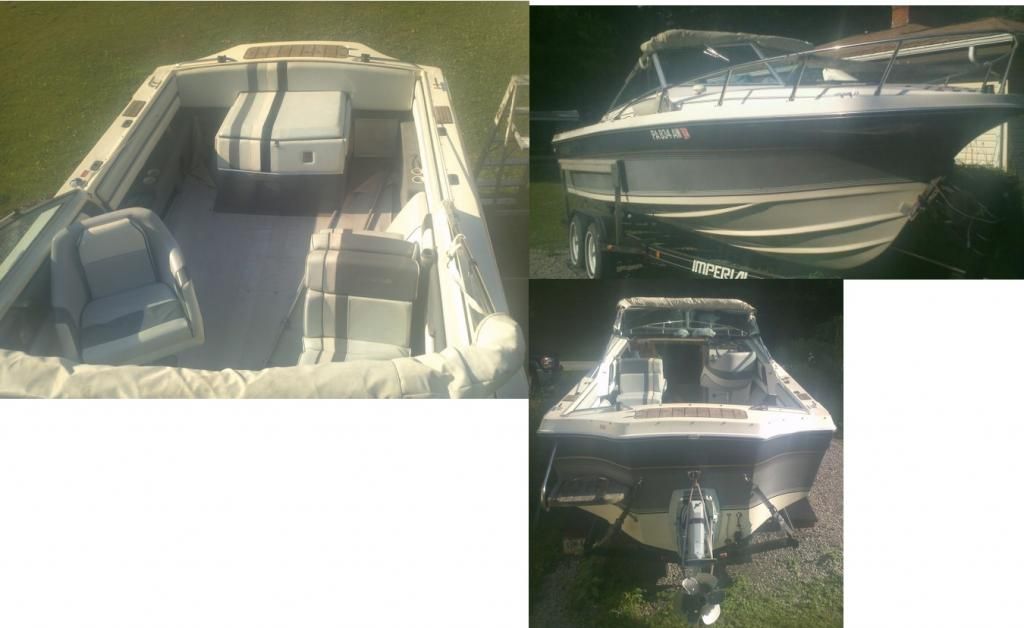

Is this similar to your boat? If so, then I think the Deck is separate from the cap. You should be able to remove it without removing the cap. However due to the way the stern is constructed, replacing the transom might be a bit problematic and offer little head room. Once you get the motor out and the seat back and all the other carp out of the way you'll be able to better determine what needs to be done to gain access to the region for the replacement. Since it's a significantly Bowed stern, I'm betting it will be a bala cored transom. This will make for an interesting replacement.
"88"imperial
Recruit
May 4, 2014
That is my style boat with what looks to be a different seating arrangement. From what I can tell with the motor still in place the transom where the outdrive mounts is a soli piece of wood. I don't know it may be cored balsa. Looks to be about 2 1/2 inches thick or so. I will post some up close pic when I can. Thank you for the replies.
