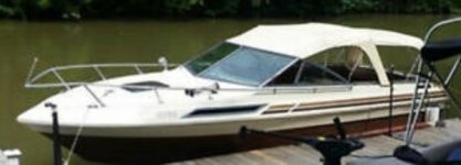

Hi everybody, I'm brand new here. I just put a down payment on 84 Thundercraft 230 or at least that's what the size on motor are and length of the boat is. I bought it pending sea trial.
Can any body let me know what to watch out for?
I have a life time with sail boats.
I just wonder if there should be something to watch our for.
Thanks for your replies.

Didnt see you reply to Bondos Stringer & transom statement. Thats always a concern for a 36yr old boat.
The 1 attached pix doesnt help much.
Perhaps its the 1 in 100,000 (or more) survivor that will perform as you expect on sea trail and poking around the bilge, motor and outdrive...
Dig in and inspect every nook & cranny you can get your hand, head, camera and/or awl into ..
