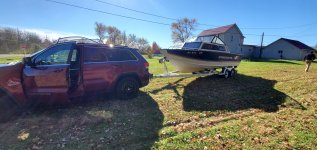

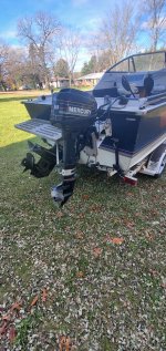

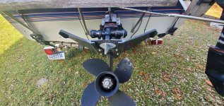

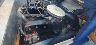

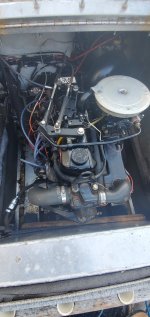

Hey guys. Thanks for the info and sorry for the lack of replies I had to run out of town. But I do appreciate the feedback. I thought Id post some pics of the boat and motor. Its actually a 3.0 as you will see but here she is!
