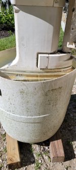

i didnt say i thought it was good i was simply saying what it was when i was running it. is there ports higher up? here is how she sat when i was running her.
is there ports above the water line behind those small covers?

Think about where your water pump is.
The water line needs to be well above the pump so the it’s completely submerged.
