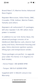

I know the carb is a Holley 4150 600 cfm and the engine is well..:just the same as any 96” onwards mercruiser or Volvo Penta 5.7 vortec carb. But rated for up to 5000 rpm I think. Whatever the cam is in the usual engines like that is. It’s the same, I’d think. Mechanical fuel pumps running about 5-7 psi low down I’m sure.
Edit…it’s as pictured below. But with petronix ignition now and Holley carbs as described above. Says 4800 rpm there at 300hp. Not sure about getting that with 4800 rpm, but not an expert. Thought his were 5000 rpm at 300hp anyway.
