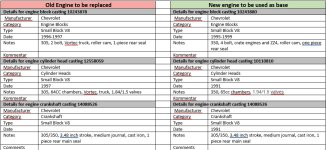

Adding a comparison table that i used when searching for parts.

You can not use the 5.0 heads on the Camaro motor
You can not use the Camaro intake manifold, water pump, accessories, heads, etc at all. Throw them away
I would advise against the Camaro pistons and rods
You will need different heads to use the VP intake which is for vortec heads
You will need different intake to use the Camaro heads (non vortec )
The VP ECM will need reprogramming with the 5.7
Your table is wrong with regards to the heads.
