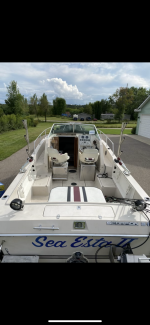

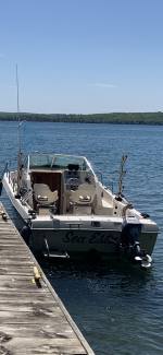

I was advised by others to join this thread as there have been lots of information of swapping a 190 to a 4.3. Based on discussion I’ve heard it can be fairly straight forward as it should pair with the outdrive and the stringers on my ‘85 Chris craft scorpion 215 “should” along to hold the v6. The hull/boat is in great shape and I think it is an opportunity to put in a little more power. Looking for advise/tips/ links to prior conversations regarding this topic - thanks in advance. I will also be interested in where to locate a remanufactured engine and a mechanic in the Midwest that would consider this project. Cheers

Thanks for the welcome - yes the 470 (190) is blown. The mechanic I am working with is actually advising to scrap the boat but it is very hard for me to do. I’d be willing to put money into it especially if there is an opportunity to put in a somewhat newer motor/refurbished into it with more power… it has potential to be my dream boat when done. However I am no mechanic and everyone seems to have different advise so it’s been hard to follow. Thanks in advance!!!!!!!
