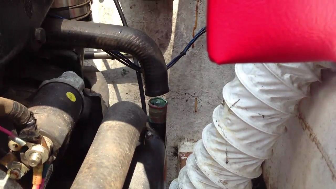

Hey guys, finally got the boat on the water today for the first real test run (after a fail last weekend with a busted steering cable). The motor runs good as does everything else, but it overheats. While idling, it will sit at 180. Very soon after putting in gear, it will creep up to around 200 almost, not quite hot enough to trip my overheat alarm, but very close I think.
The impeller is new, heat exchanger was cleaned out, all engine coolant replaced with 50/50, new thermostat (160 degrees), and new radiator cap.
I pulled the aft hose on the heat exchanger (that goes to the exhaust elbow). I put the garden hose into that hose, and got a ton of water out of the exhaust relief ports on the drive, as well as the little drain hole on the bottom of the drive. So I think the exhaust side is clear.
So I hooked the muffs back up to the drive, and fired up the motor for a few seconds to see how much flow from the drive and impeller I was getting. Here is a video of the amount of water going through from the garden hose. Does this look like a normal amount of water to get pumped through, or should there be more and I should look for a blockage somewhere between the input hose on the transom plate and the heat exchanger?
Thanks for any help, trying to get it straightened out for another run tomorrow! It's great to finally see the years of hard work on the water! :joyous:

That didn't look bad for idle. Time to make sure the temperature gauge is reading correctly

I believe the gauge is working correctly, I checked it with an IR gun to make sure and it seemed pretty close.
I wish I would have pulled the hose from the voltage reg. to check the flow while we were still at the lake. Since it seems that the flow through the heat exchanger is acceptable, what should I check next?
I'm wondering if there is a blockage in the exhaust, somewhere after the exhaust pipe. The original shutters were completely gone, and I never found them. I wonder if this could be the problem?
One thing to note is that when the engine is on muffs idling, there is only water coming from the starboard side exhaust relief port, nothing from the port side. Is this normal? There is also a small stream from the prop, but not much.

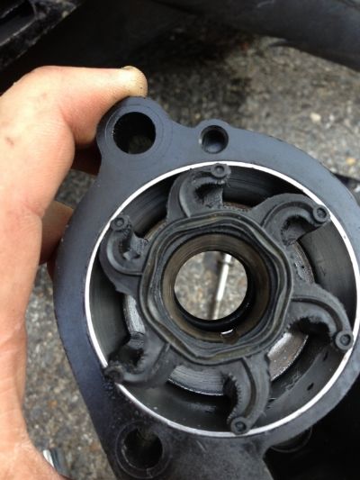

Here is a couple pics of the impeller and housing. What do you think? This impeller is basically brand new except for a few runs on muffs and the test run in the lake today.

It looks like the rubber has slippedoff the pump core. try pulling the rubber away from the core. if you can even move it a little the impeller is done.

Bt, I knew that impeller core looked funny but I didn't think that the core may be spinning in the impeller. Is this what you think could be happening? I'll give it a check as soon as I can, probably in the morning.

Yeas, just doesn't look right. Still think it would be a good idea to instal a new OEM pump housing and impeller, then you will know you are OK. IMHO

Merc and Sierra both had a bad batch get by.The rubber was not bonded correctly to the core and woould start slipping.
All the ones i`ve seen have had the wavy appearance and the rubber could be pulled away with your fingers

Well, the impeller doesn't seem to be separated from the core as far as I can tell. I pull on the impeller away from the core and it seems well attached all the way around on both sides.
I wonder if it's possible that the core is actually spinning within the impeller, and it gets hot enough to melt the rubber and is stuck back to the core after the engine is turned off and the melted rubber cools? Just a thought, doesn't seem likely though...
I'll be replacing the impeller and housing anyways, just to knock that off the list.
