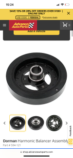

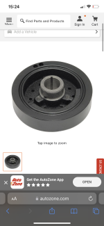

Sooooo after further investigation. I believe that someone may have switched the balancer on the left with the one on the right.

Trevordakid
Nov 8, 2023
23
I got a 454 gm mercruiser or whatever u call it. Older model Mark IV 454 I believe. I bought recently and it has been shaking around 3500 rpm. I have looked at the harmonic balancer and noticed it does not have a weight on the inside. Do all 454s have weights in the harmonic balancer. Picture on the left is what I have on it now and the picture on the right is what I’m referring to. Could this be the cause of the vibration? Any feedback helps :)

kenny nunez
Jun 20, 2017
3,569
The un counter weighted balancer is probably from a small block engine that are internally balanced. A good thing that you found the problem.
