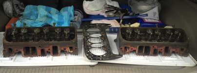

On a marine inboard with a bent pushrod like that I'd be thinking of checking all the valves to see if any are stuck and also check the exhaust manifolds to see of water is leaking back in the exhaust ports.
Lou C
Nov 10, 2002
14,276
For a stuck valve you are looking for one or more that are lower than the rest...here are the old heads I removed from my 4.3 when I had the blown head gaskets back in 2016, if you look closely you can see a couple valves that are lower than the rest...this was due to water in a couple cyls, not enough to hydrolock it or cause the valves to stick enough to bend pushrods, it would run rough when cold and smooth out when it warmed up. I wound up replacing the heads with reman ones.
