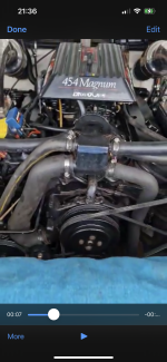

There is a 454 magnum 4 barrel carb AD. 100%. Was working on a boat with one just a few months ago and know of a few others too. Supposed to be something like 350hp. Opposed to the usual 7.4 carb of the same era, producing something like 310 or similar

Here is the actual one I was messing with not long ago. Fitted to a formula. Some of her components may have been altered over the years, I might suspect though. But yeah…they definitely exist!

Maybe picking you up wrong. I thought you were perhaps suggesting there wasn’t a carb 454 magnum? There was a magnum in both carb and mpi/efi forms. At the same time as the magnum 454 carb…there was also the usual and more common 7.4 carb with less power.
Later as you’ll know, there was the 7.4 mpi with the 310/330hp or whatever they are…but also the more potent mpi magnum too. With different intake and cam (as Scott mentioned). As you’ll know too, obviously
